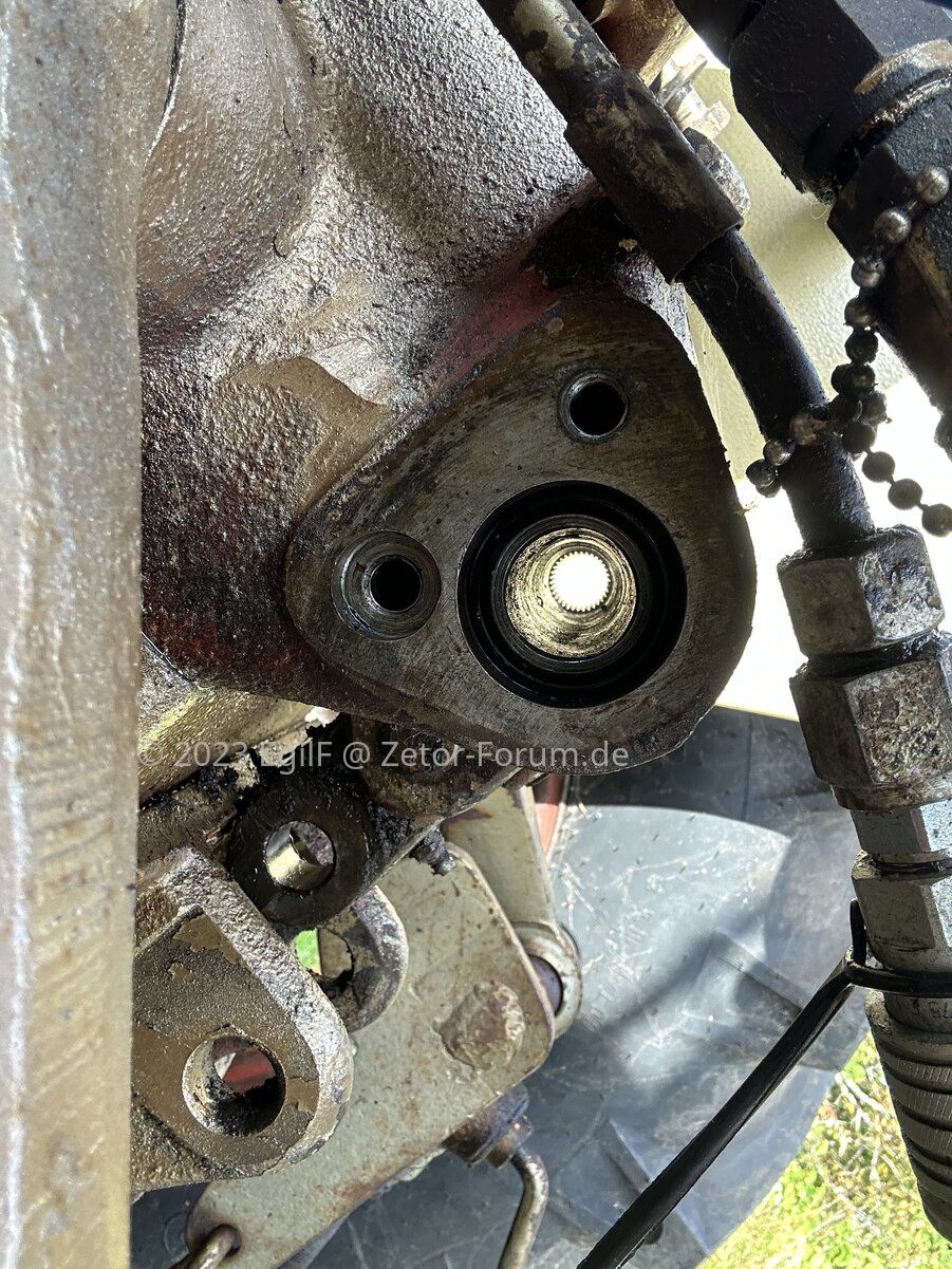

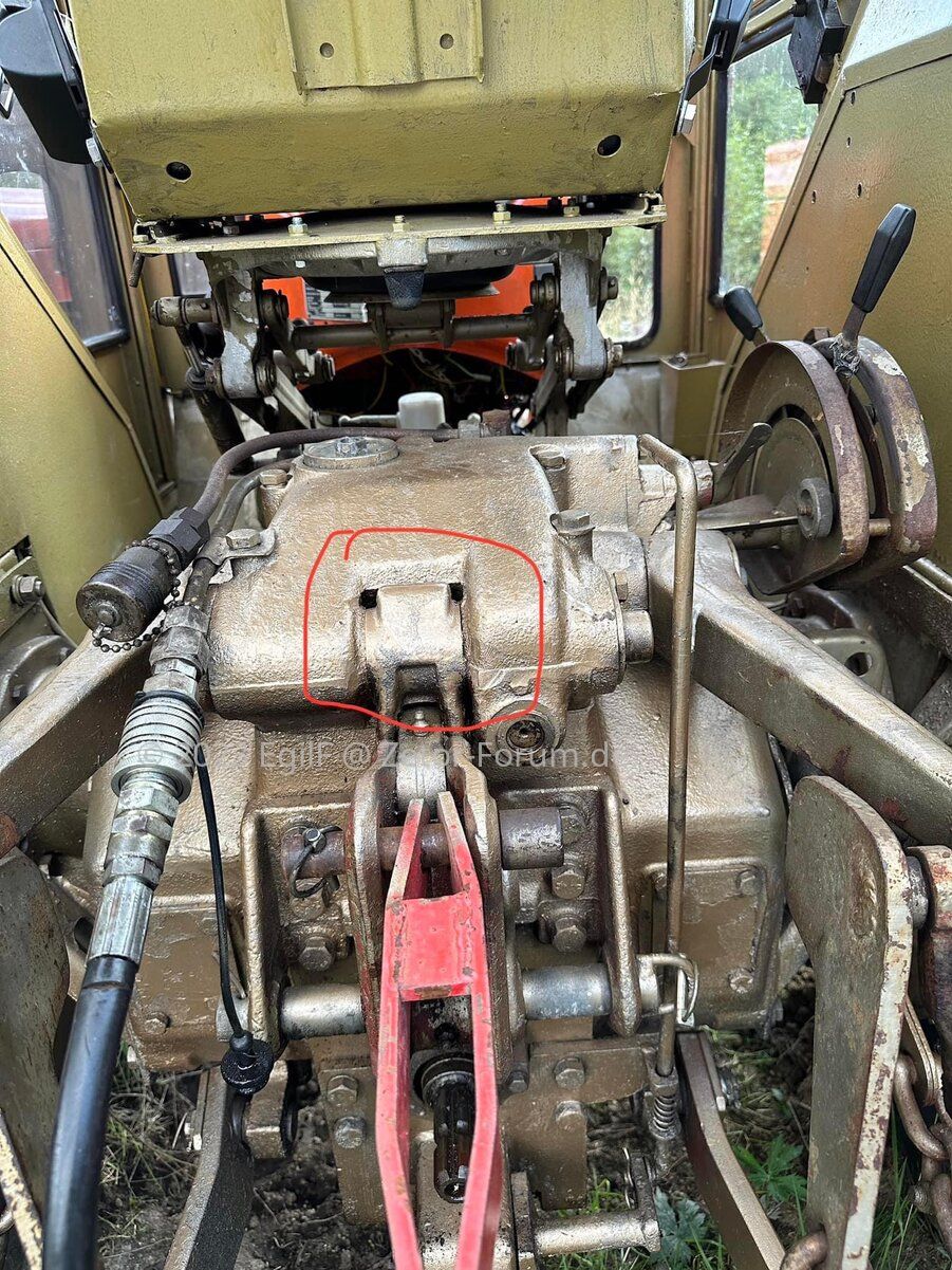

How do I get the bolt out at the top of the top stay mount to change the two middle shim rings? I have heard that the bolt should be split and taken out to the sides. But it seems like it's whole, and I can't get it out on any of the pages. Does anyone know how to do this? It is a 1976 model 5745.
Tried to get a perfect fitting peace of hardwood like oak and slam it out with a hammer?
