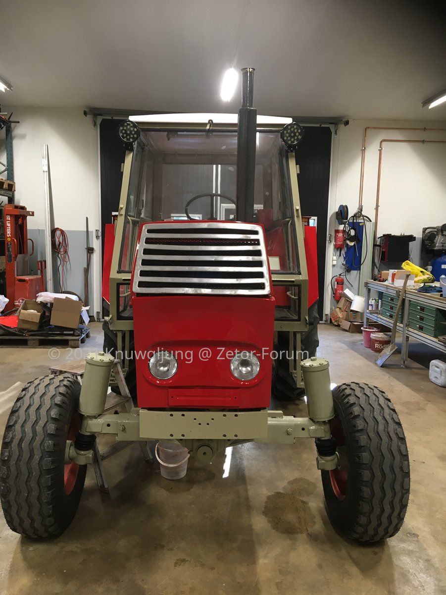

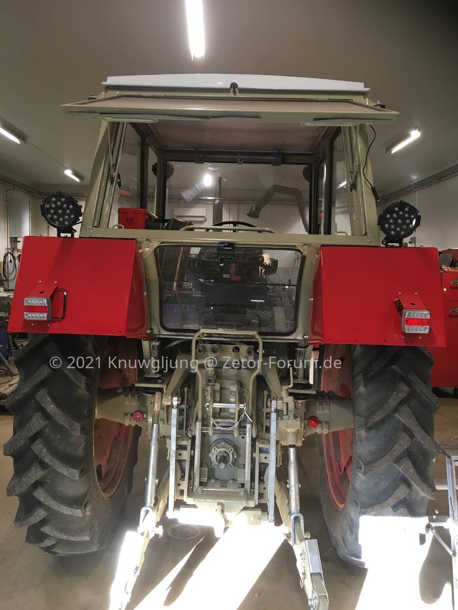

Thankful for your help!Leaving you some pictures of the renovations to enjoy. This will be a real working tractor on my small farm, running hay and mowing, so the led lights etc may not be period correct, but really practical. It will be getting a decent front loader as well. . I'll be posting a larger update of the progress later in a different thread.
