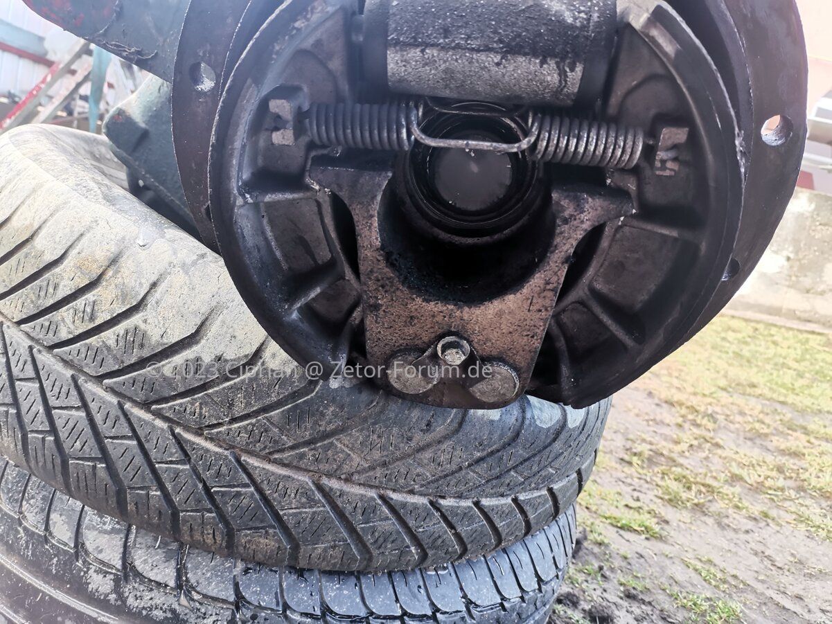

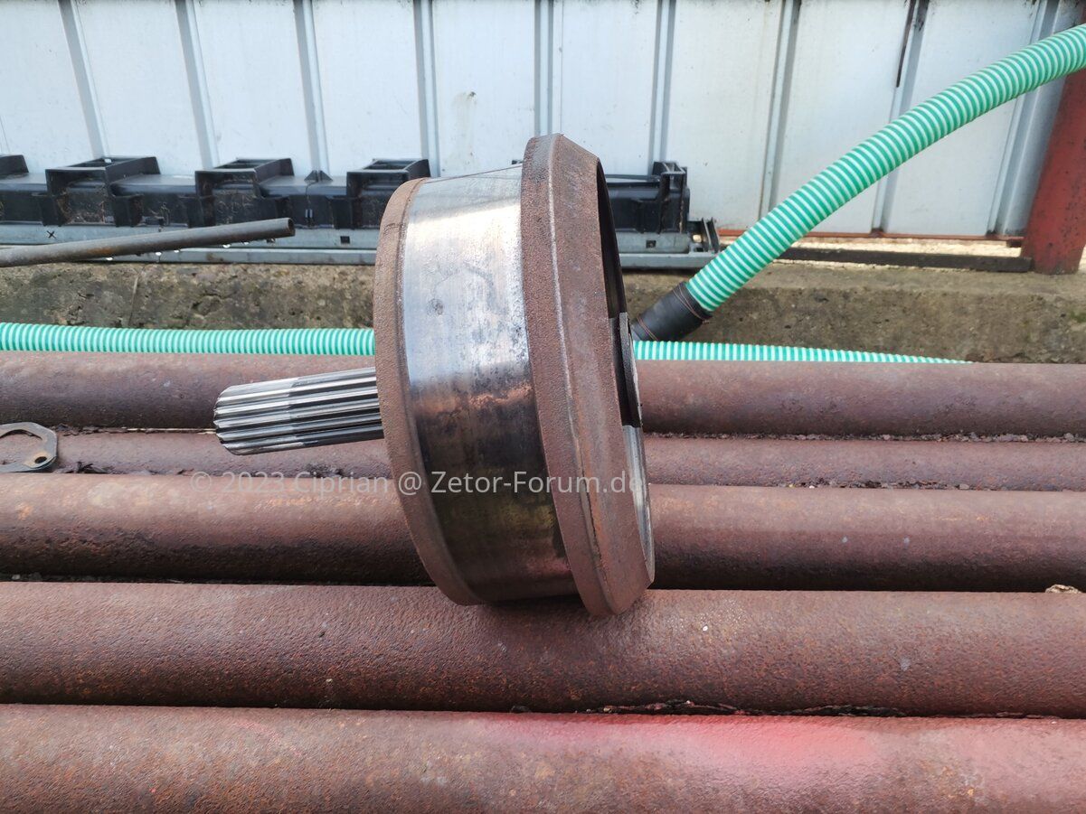

Hello guys! i have a problem. 5 months ago on the right side differential shaft was broken. i changed it but now it's broken on the left side, same as the last time. which can be the problem? Sorry for my english.

I think:
- not proper setup your differential shifting (the diff is ever aktiv eg.)
- or you have a problem with the diff it self (blocking gears eg.)
But first try to look at your settings at the differential shifting - I have never seen such massiv broken diff shaft. Its not normal.

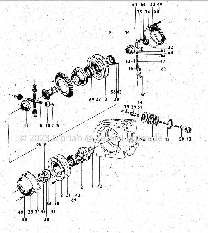

So, to check settings at the differential shifting what i need to do, because it will be the first time when I will disassemble the differential.

You need only a litle bit grasland and then you can try out best setting by try and error. Its the only way to do it.
Set it up at this screws:
longer = the diff shifts later
shorter = the diff shifts earlier
best point = screw it so the diff is active (shorter) - the unscrew it bit for bit up to the point the diff is off - at this point fix the screws. Thats all.
