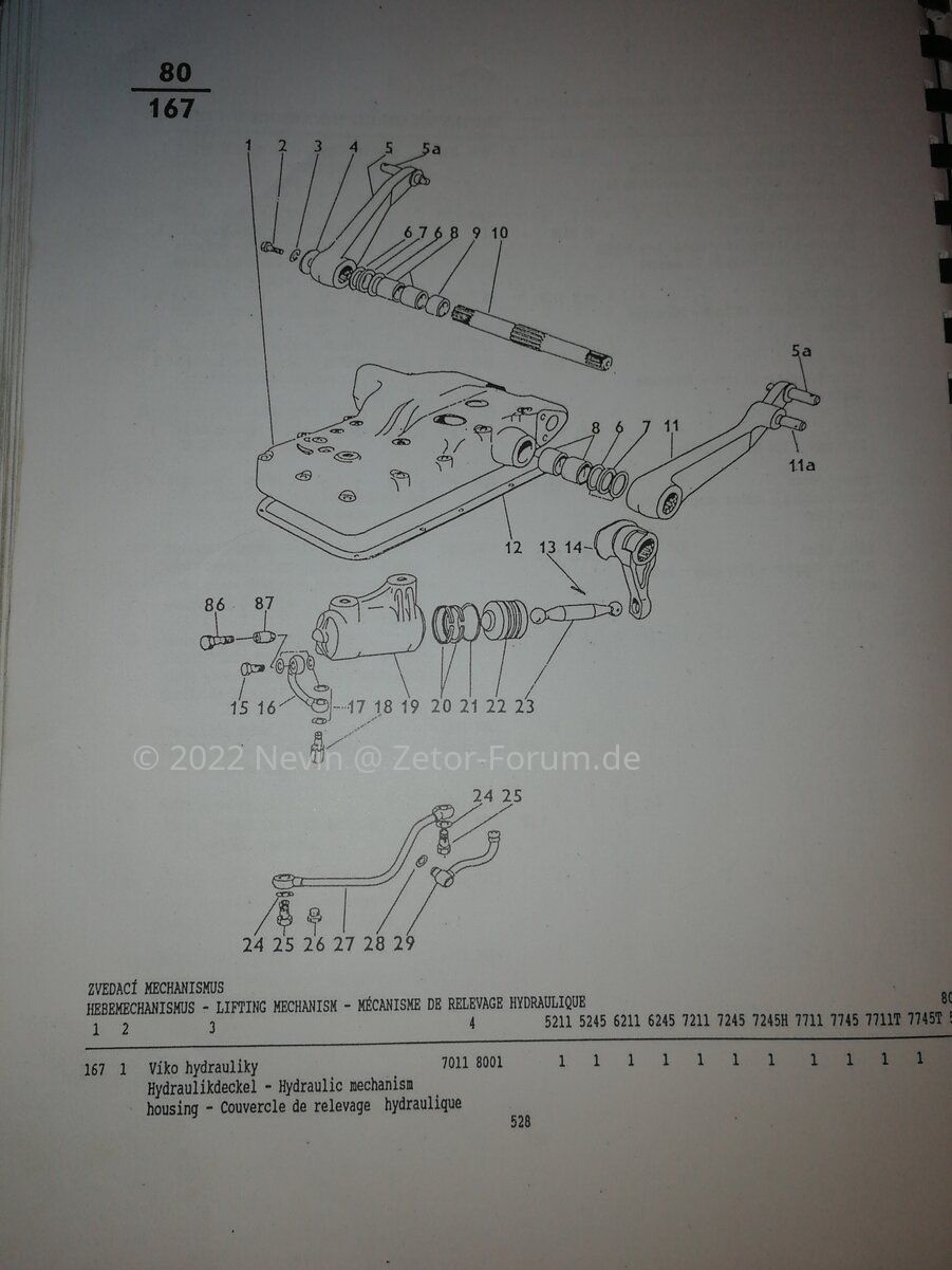

Frage Zetor 6211 Rear Lift Assist Ram
In the Video is a 7245, ist a number bigger than a 6211/5245.

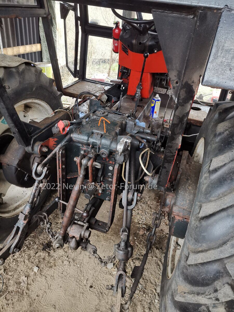

The picture is my 7745
Is there a filter in the housing ? Is is a replaceable one or just to be cleaned and reinstalled ?
Is the dropping and jumping up of the lift likely to be the piston o-rings ( #21) worn down or perhaps somehwere else below?
Thanks
just clean it - its a magnet and a filter, its often forgotten and then it looks like your ones.
And then you find a second one in front of your fuel tank - its also a hydraulic filter and you need the filter and 2 rubber rings.
And... pleas simply download a user manual for your Zetor - this helps you so often to understand your tractor and answers simple questions like the one about the filters. Its free, no costs - download, read, be happy.
