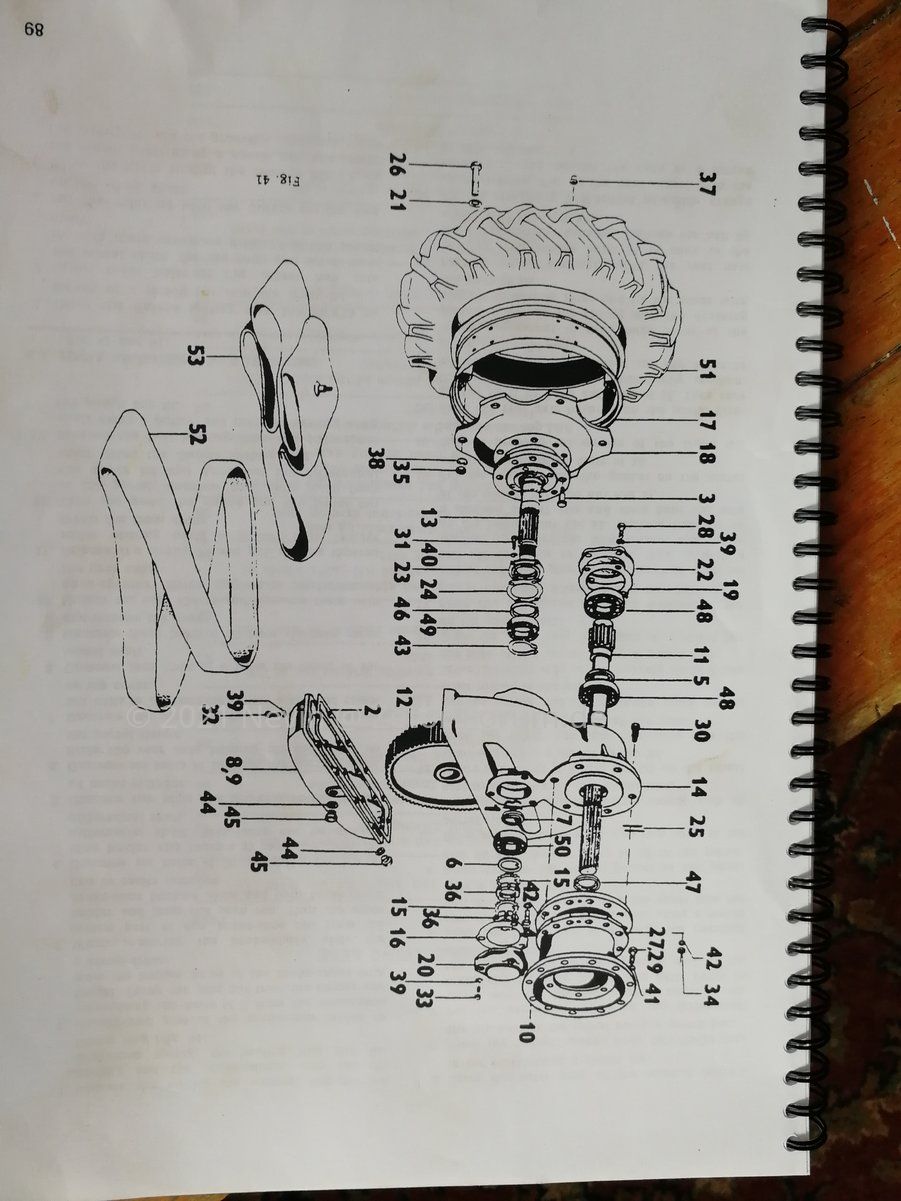

Hi, new here, I'm from Ireland so I speak English but I use Google translate here.
I have a Zetor 6211 and back right wheel bearing is making a bad noise.
Is there anyone that could walk me through (pictures would be great) changing the bearings.
So
# 1 - Is there any tips fro removing the KM11 Locknut as I wouldn't have any special tool for that.
#2 - if I can remove that nut is there a second nut (looks like another of the same nut on drawing )
# 3 - Once I remove the nut / nuts does he whole shaft slide out? If so is the inner bearing changed while shaft is out or from behind the portal?
I have attached the picture of the whole setup from my zetor book.
Thanks so much.

Hello Nevin,
nice to hear from you. No problem, we can speak some english, I hope enough to talk about your workshop challenges.
I am at the same work on my tractor. One side is already done, from the other side I can sed you some pictures today or tomorrow.
Are you sure that the bearing 49 and 50 are the problem? I think the two numbered 48 are the foulty ones. They are not below the oillevel and because of that bad lubricated. To cange them you have to remove the whole Axlegearbox with brakes from the tractor dismantle everything you see in your picture and replace the bearings 48 with a hydraulic press.
To #1 and #2 the nuts are easy openable with a hammer and a skrewdriver. They are screwed against each other to adjust the bearing force of the tapered roller bearings. There are loking plates betwen the nuts to holt the nuts in place securely.
To #3 Yes the whole shaft comes out. You have to open the gearbox and catch the big gear and some distance parts.
Then the problems will start. Removing the outer bearing from the shaft is not that easy but possible, I can show you some pictures later.

Hello to Ireland and welcome Nevin!
You need something like this:
BGS tools number 8542
But before you disassemble everything, you should try to readjust the bearing. They are tapered roller bearings and they have to be readjusted from time to time, just like on the front axle if it is not a 4x4.
Often the noises of bearing play come from wear.
If the bearings are in order, it is usually the upper ball bearings of the upper shaft, these sometimes get too little oil for lubrication and then they suffer.
Yes, the flange shaft can then be pulled out and the large gear can be removed to then dismantle the bearings.
But you also have to loosen the bearing cover on the outside beforehand.

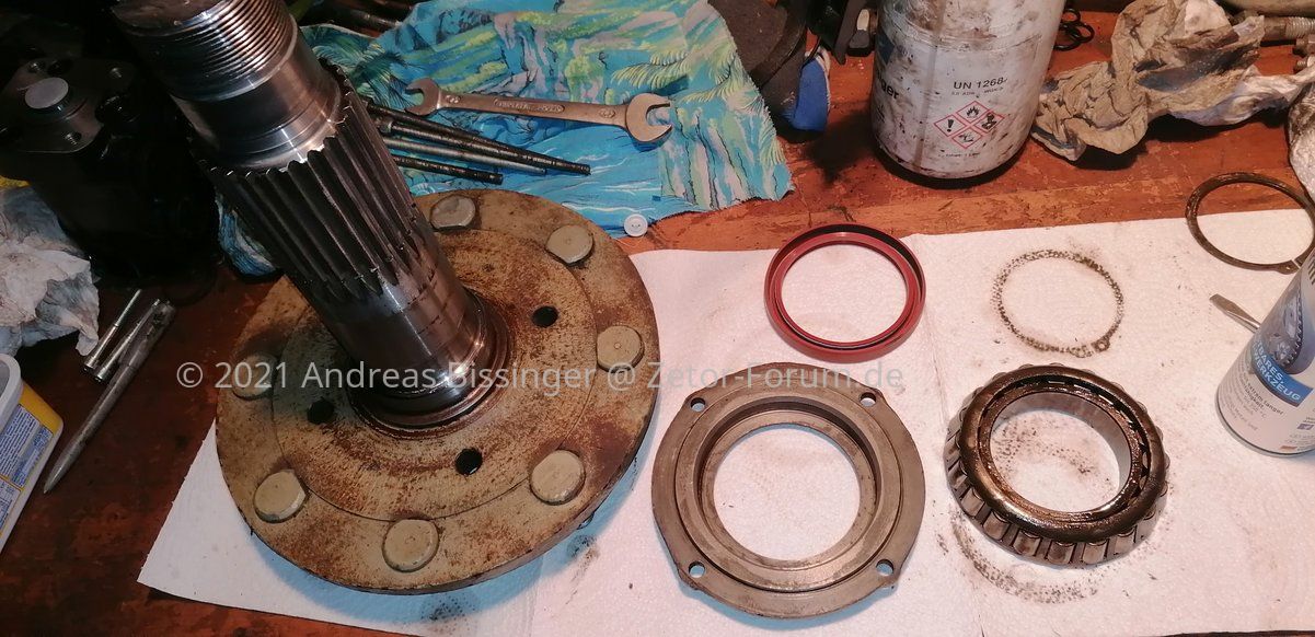

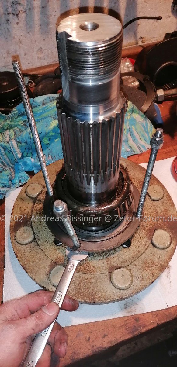

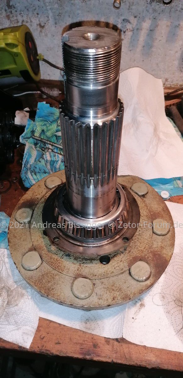

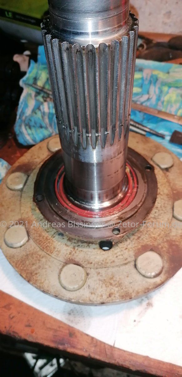

Here the pictures of the demounted axle:
You have to remove the whole axle with the outer bearing on it. That should go verry easy. I think you forgot to lose the four allen screws on the outer bearing cover.
To remove the bearing from the axle i used four treaded rods to push it off as you can see on the picture.
To mout the new bearing on an easy way I put them in the Kitchen-oven at 120 Degrees Celsius for 10 minutes then I could push it without trouble back on the Axle.
