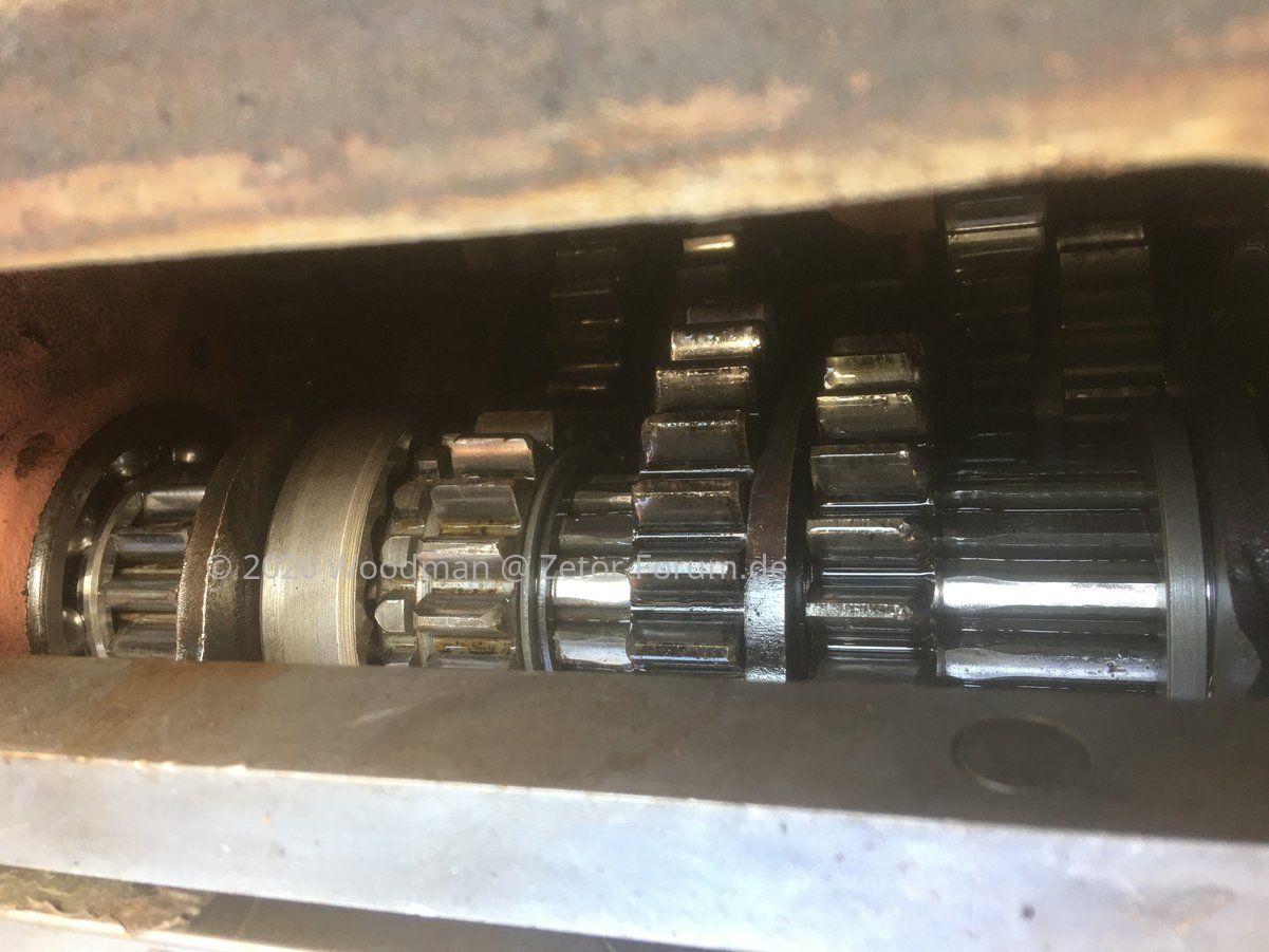

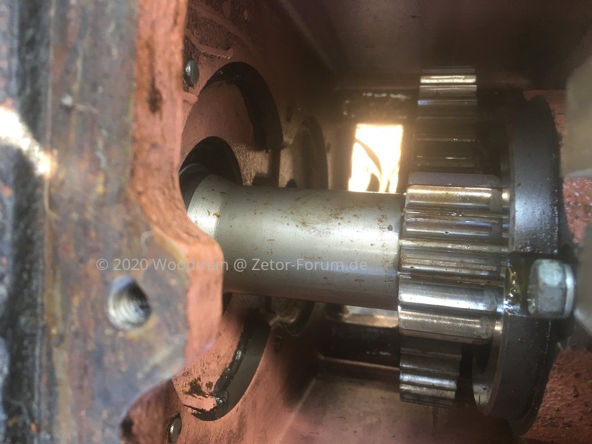

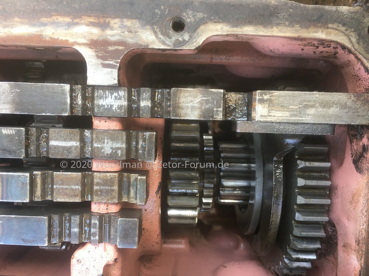

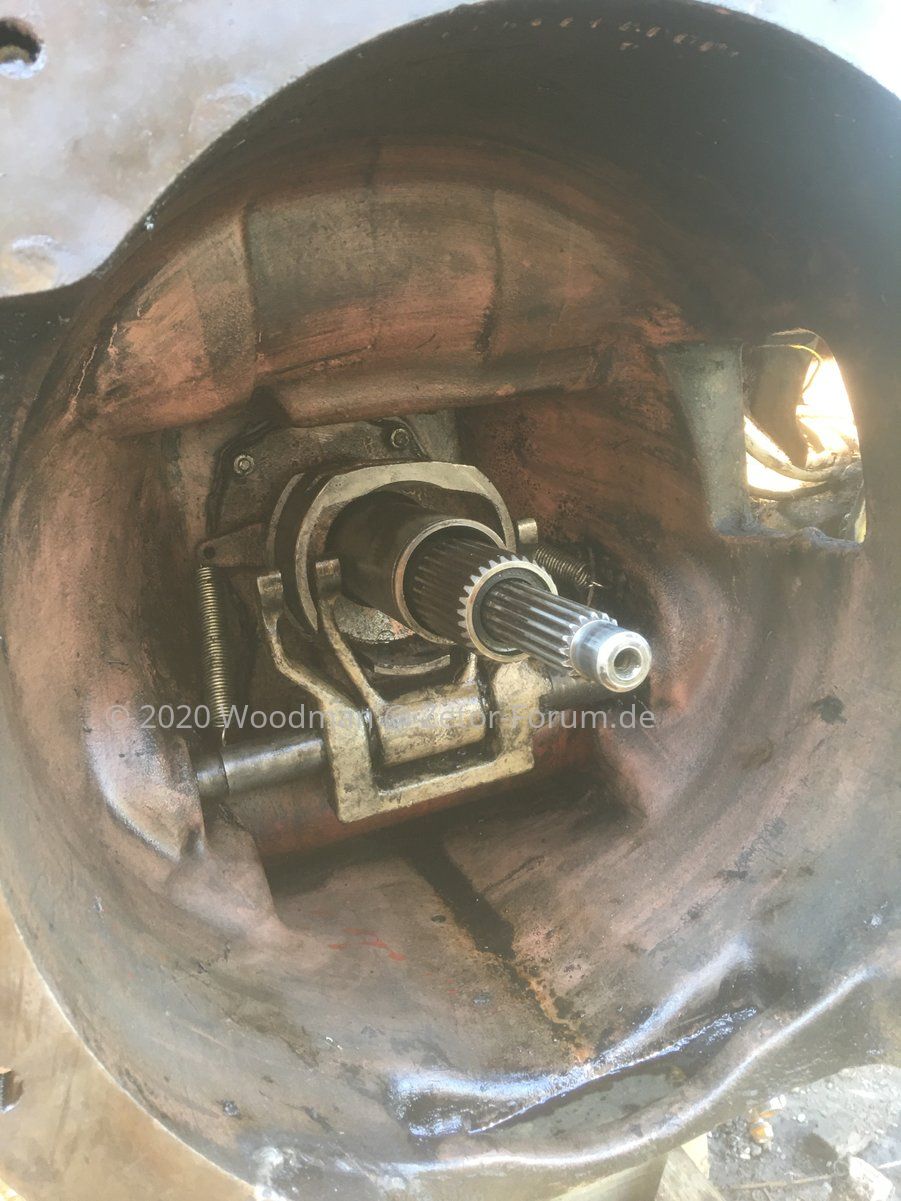

Hi everyone
I've took some pictures of the zetor 5011 gearbox and everything looks okay, but the pro shaft and the clutch shaft have a lot of play
