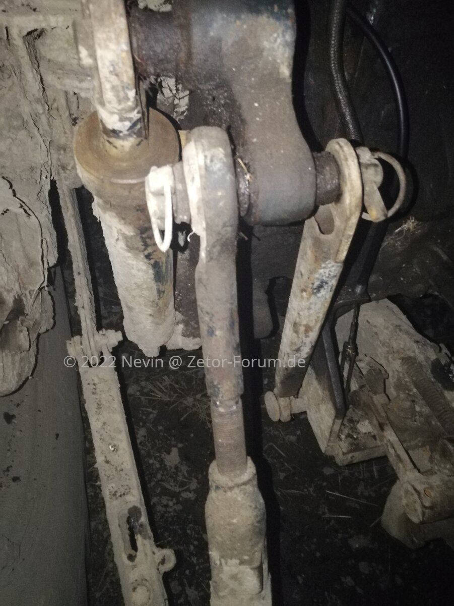

Hello, could someone explain how this ram works and it's function. The current one doesn't seem to be in great shape.
Is the lower pipe the flow in and the top flexible pipe the return ?
On mine the top pipe doenst seem to have any fluid flowing to it. There's fluid flowing into the bottom pipe. Is the ram now allowing it to flow through?

Not a great image but all I have right now.

I am talking about the lift assist ram/cylinder
See here
How does it work, it's function and what direction the flow of oil is with regards to the 2 pipes.
Thanks
... you mean the hydraulic cylinder...
It's a single-acting cylinder, it can't push - no UR1 Zetor can push down way. It's also just an auxiliary lift cylinder, the main cylinder is in the differential box.

A Zetor 6211 have one cylinder inside - ALL Zetor 6211 have them, and its only one version. It have one pipe betwen them and the hydraulic block.
Most Zetor 6211 have also one (certain also have two) extra hydraulic cylinder at the outside. This one has 2 pipes, one for pressure and one only to bring back droping oil from cylinder to the gearbox.
