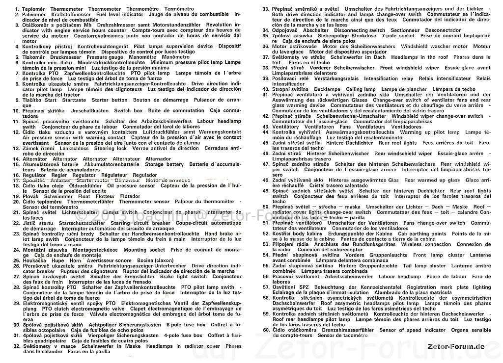

Hello,
oh sorry, the numbered list is not in the library yet,
but this ist the list to the wirring diagram from 5211 to 7745:
The Zetor 7045 is practically wired nearly equal.
Does that help you? I have on my Zetor 5011 on the way to work and the complete wiring harness ...
