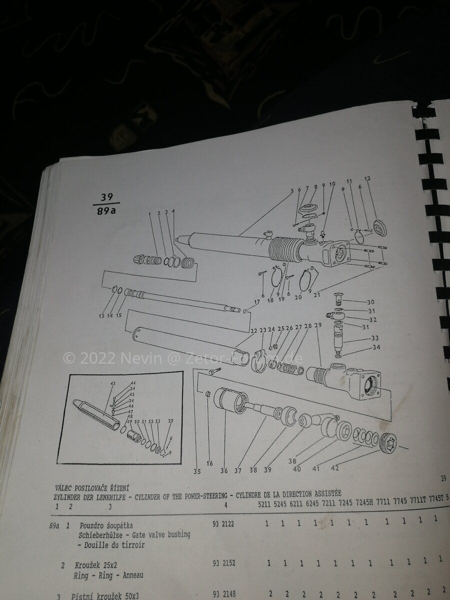

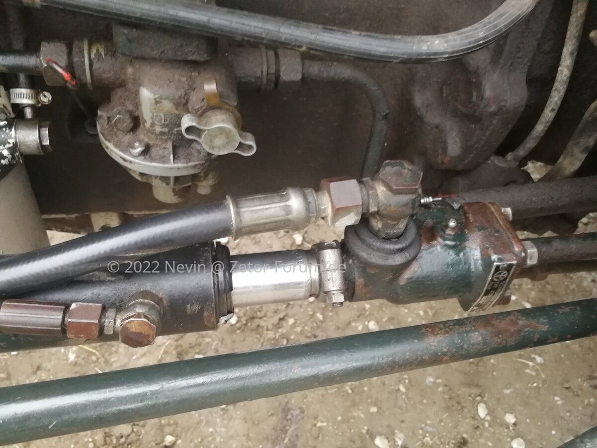

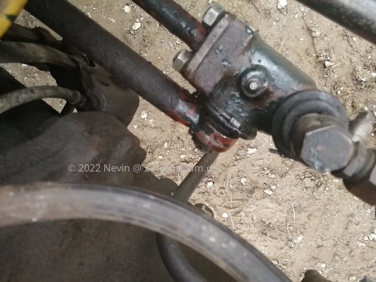

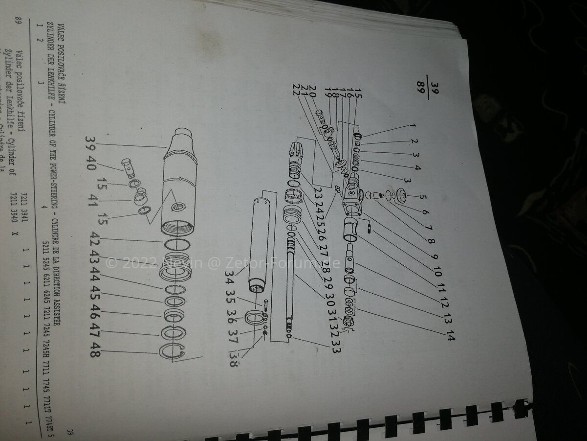

Hello,
Has anyone rebuilt their power steering cylinder.
I believe my own is leaking out at the head #9
Coming out at #8+#5 , perhaps o ring #6+7 are gone.
Anyone shed some light of replacing these or a possible old thread on this ?
Thanks
Here are some images.
Is there two variations of cylinder ?
From those photos is it possible to say which version of cylinder I have ?
Thanks
Yes. 2 major versions to be exact and a few minor versions of these 2 major versions

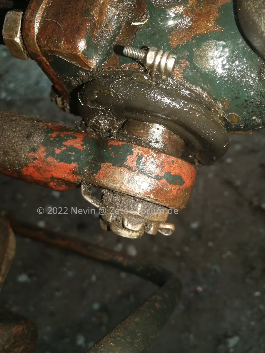

No - at this point it comes out, but its leaking at other place. Often at the litle AL-ring or at the rubber ring pos. 29.

Take a look at your parts book pictures, its the Jihostroj version - if older or younger I can only say when I see it unmount from the tractor.

Jihostroj (simply check the picture and than your cylinder)

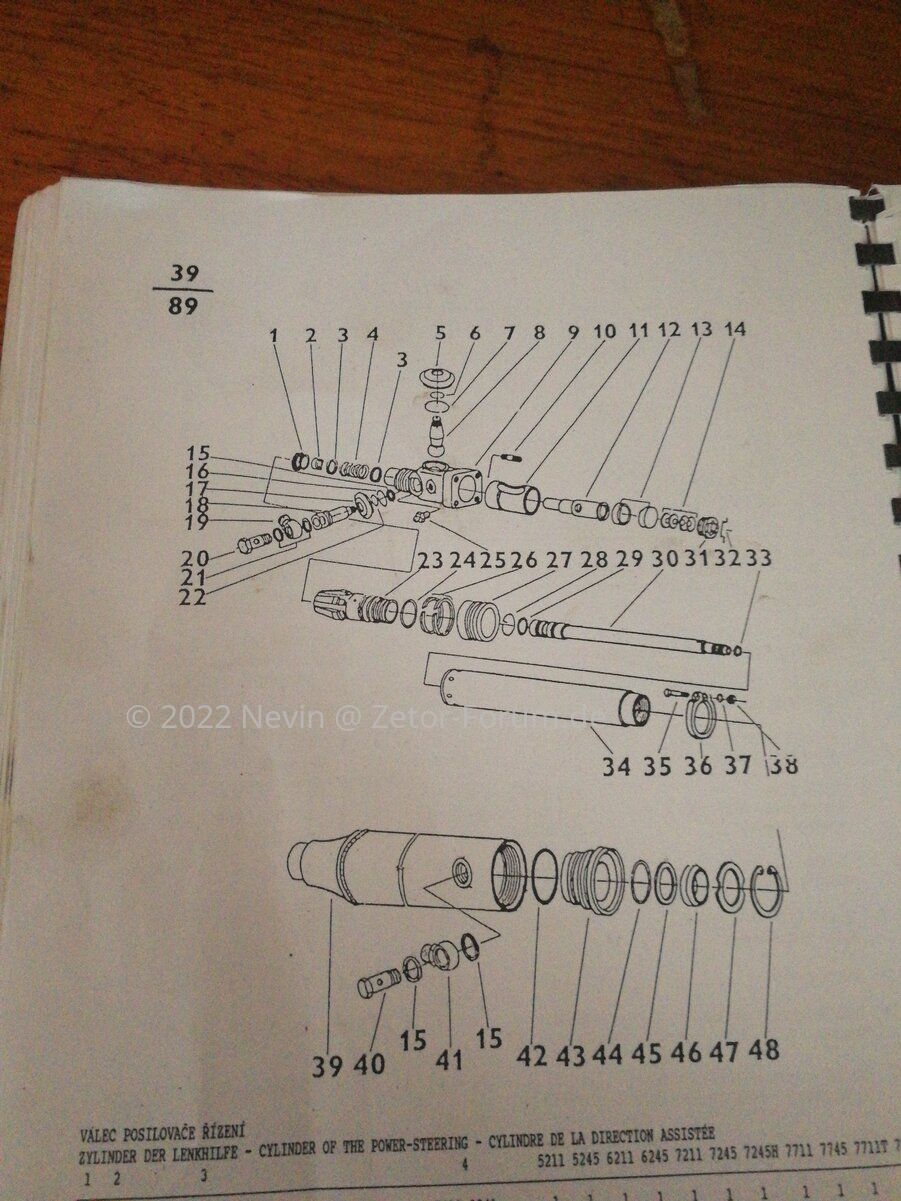

The other one:
And from both versions it gives newer and older ones with realy only little changes. The working principies are allways the same.
Ok I will examine the parts book. Could you detail a couple of the differences as to a novice, it is not so clear . Just don't want to be working from the wrong picture or ordering wrong parts
Would be a great resource
Thanks for the help.
Its not to hard - take a look at the parts book, the pictures and the parts numbers - you can then find all the differences betwen both power steering cylinders.
The biggest difference will be this parts:
(Jihostroj type) = your type as I wrote you
and the other one:
... not your type
but... its not so interesting for you as I tell you above what type of cylinder you have. Or?

Perhaps that could be it .

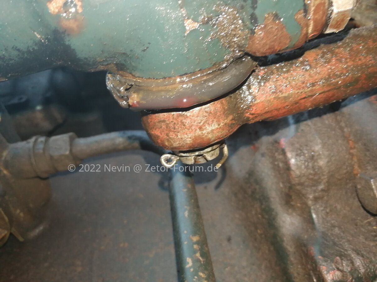

This is a photo from before it was removed for repair. Too much grease at the right side ( back rear end ) ?

to much grease (red arrow) or ...
wrong remounted spring / wrong spring settings inner the cylinder pipe.
The last one (spring settings) is to setup when the cylinder parts be remounted - this should do the hydraulic shop if she knows whats they do at such cylinders.
