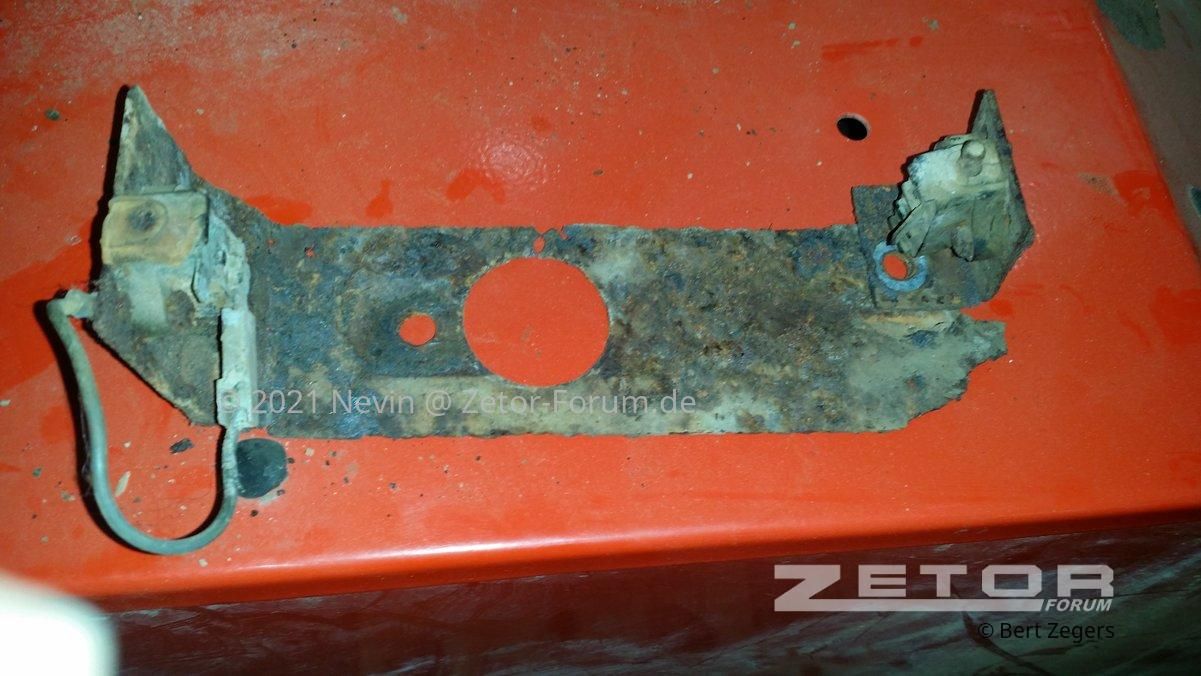

I was at the shop where the Zetor sits, and took some pictures. This is the bracket with the switches that sits under the parking brake and PTO lever.

Also does that holder mount under the bracket that holds the handbrake and pto handle? ie do i have to take them up or does it sit and bolt down to them ?
Thanks
That holder mounts under the bracket that holds the handbrake and PTO handle. You would have to disconnect the handbrake and PTO cable.The holder is actually 2 pieces on my 7045.

Hi Bert would you know the OEM number of the right side metal part in the below image.
Have looked at drawings but only the main holder piece is shown which only allows the handbrake switch to be mounted but as you said before there seems to be a 2nd metal piece needed to bolt on the PTO declutching switch.

I have not seen an OEM number either. Next time I go to my sons farm, (where the tractor sits) I will take measurements. It is a simple piece that would be easy to fabricate.
Ich habe auch keine OEM-Nummer gesehen. Wenn ich das nächste Mal zur Farm meines Sohnes gehe (wo der Traktor steht), werde ich Messungen vornehmen. Es ist ein einfaches Stück, das leicht zu fertigen wäre.
Ok thanks, yes its a hard piece to find information on. Anyway ill probably juts make up something to suit.
