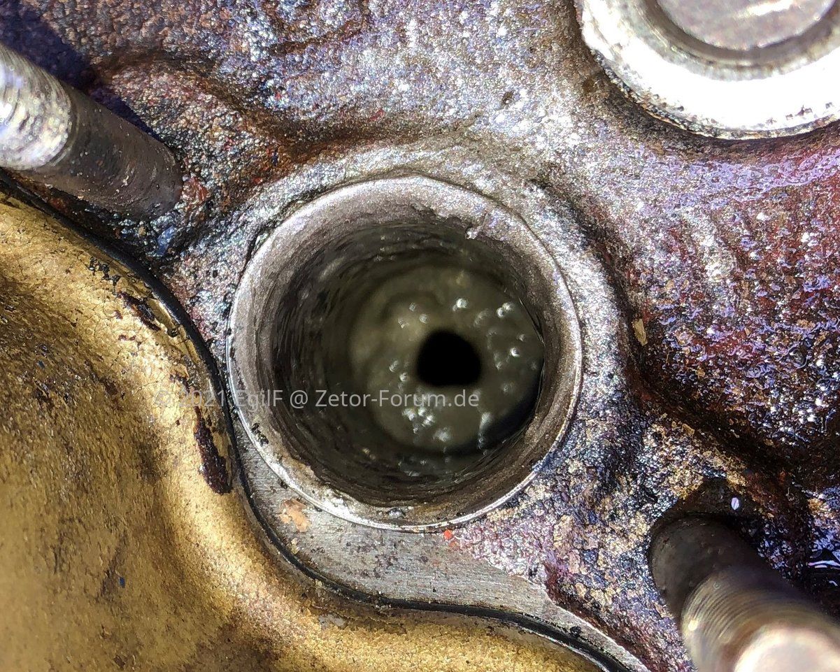

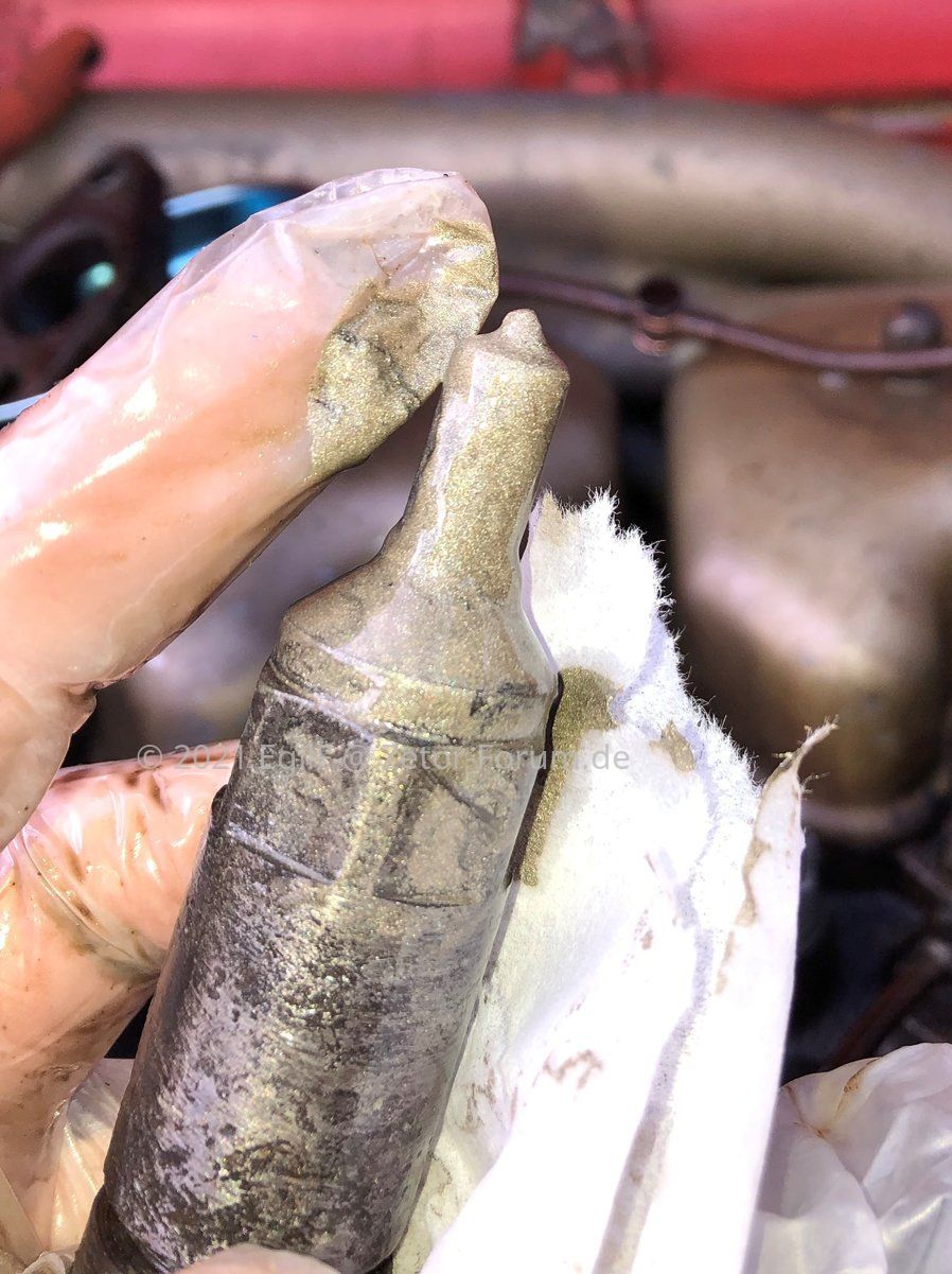

My 5745 has blue smoke and I was advised to drive it hard so that old soot and coke could be burned away. But I did not get to try it completely, because the engine power was weaker than it should be. After reading about the injection nozzle here, I tested them and turned off the diesel supply on one nozzle at a time. On three there was a noticeable difference in the engine speed, but on the 4th there was no change. So I changed the injection nozzle. Then I see that in three of the cylinders there is a mixture of oil and water around the nozzle. The gray mass is a sign of oil and water. (Picture). I also found that it leaked diesel from one - where I made a red ring.
The engine oil does not have this gray color, it is thin (maybe there is diesel in it? I do not think it smells like diesel from the oil, but do not know for sure.). I changed the cylinder head gasket (and oil) this summer, and have driven less than 10 hours since then. Before I replaced the head gasket, there was pressure in the cooling water so that it bubbled heavily in the radiator and the water was thrown out. Can the oil and water mixture be there from before I changed the cylinder head? Could it be the Injector holder bush or the sealing washer that leaks?

Eigentlich sollte da kein Wasser sein kann es sein das du den Motor abgewaschen hast mit dem Kärcher :unsure
ich gehe mal davon aus als du die Kopfdichtung gewechselt hast auch den Zylinderkopf zerlegt hast also waren die Düsen ausgebaut oder waren sie noch im Zylinderkopf wenn ja kann der Schleim noch von vor der Reparatur sein

Look with a flash light through the injector hole to see the piston. The color gives you an indication, dull black is what you want to see. If your engine oil is not "milky" and the cooling fluid has no oil in it than I would first try to get cylinder number four running. Check valve play and test the injector from cylinder four.
Clean the leak in the red circle with brake cleaner, and than watch where the fuel leaks from.

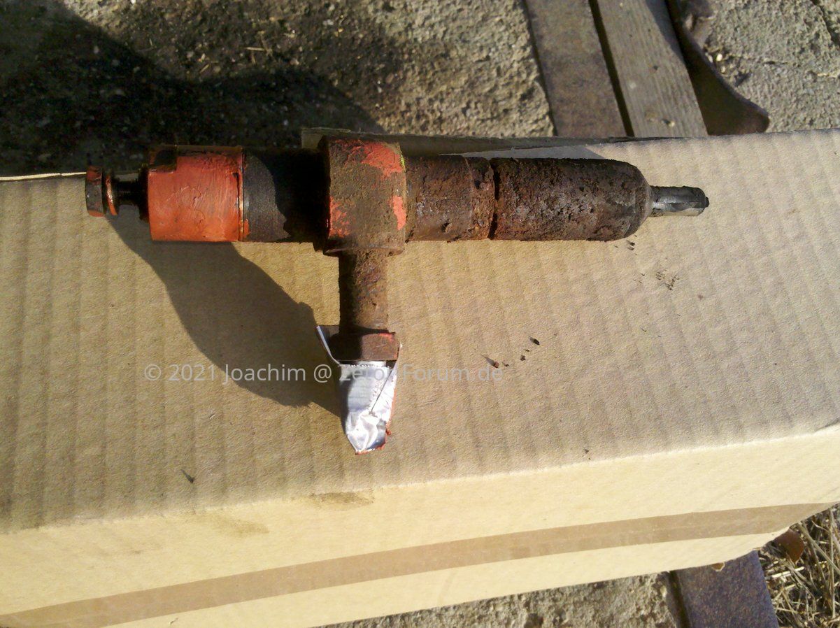

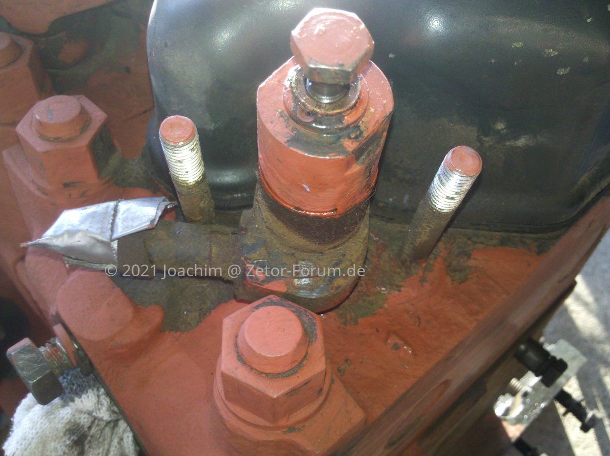

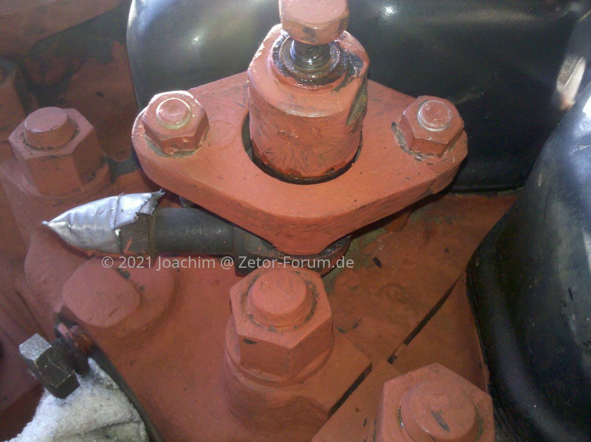

Yes, you can. Simply unscrew the Injector saddle, the pull out the complete injector.

Ja, du kannst. Einfach den Injektorsattel abschrauben und den kompletten Injektor herausziehen.

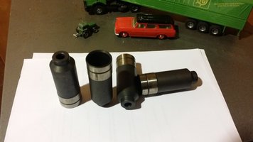

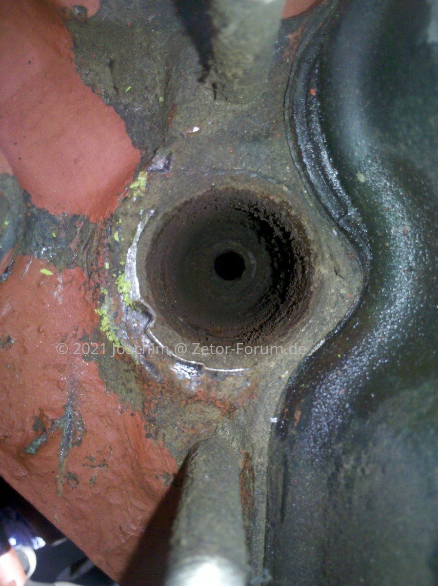

Ich denke ja eher, seine Einspritzventilbuchsen sind durchgerostet. Diese so, ohne Demontage des Kopfes, auszuziehen, scheint mir schwierig.
So etwas bedarf einen Eigenbau- Auszieher. :top:
Ein Motorenbauer drehte an meinem Problemfall einen passenden Gewindebohrer in die Hülse, schwächte somit schon das Material und konnte somit von innen, also Kopf abgebaut, durch das Injektorloch mittels harten Dorn, ausschlagen. ;)

Nichts ist unmöglich... Ich habs schon gemacht, sollte man aber nur machen, wenn man sich das zumuten möchte. ;)
Zuerst das Wasser vom Motor runter, am besten danach ne weile stehen lassen, und dann erst die Buchse ziehen. Dazu in die Buchse eine Gewindestange ein-/anschweißen und die Buchse dann mittels Schlaghammer heraus ziehen. Den Schmutz der unweigerlich rum krümelt, mit einem gute Sauger und Adapter auf einen kleinen dünnen Saugschlauch absaugen und aus dem Brennraum auch aussaugen (Fummelmist, gelingt aber, da der Dreck normal ausschließlich in der Brennraummulde landet).
Das selbe noch mal nach dem säubern, und dann die neue Buchse mit neuer Alu-Dichtung und mit etwas Flüssigdichtmittel mit Hilfe eines Einschlagwerkzeuges (hat unten die Form des Einspritzdüsenhalters) einschlagen bis sie sitzt.
Hat man ordentlich gearbeitet, dann Kühlmittel drauf, Sichtkontrolle, Düsenstock rein und Testlauf.
Geht schon, wenns sein muss ... aber geht erheblich besser wenn der Kopf ausgebaut ist, da haste schon Recht. :)

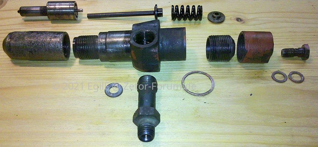

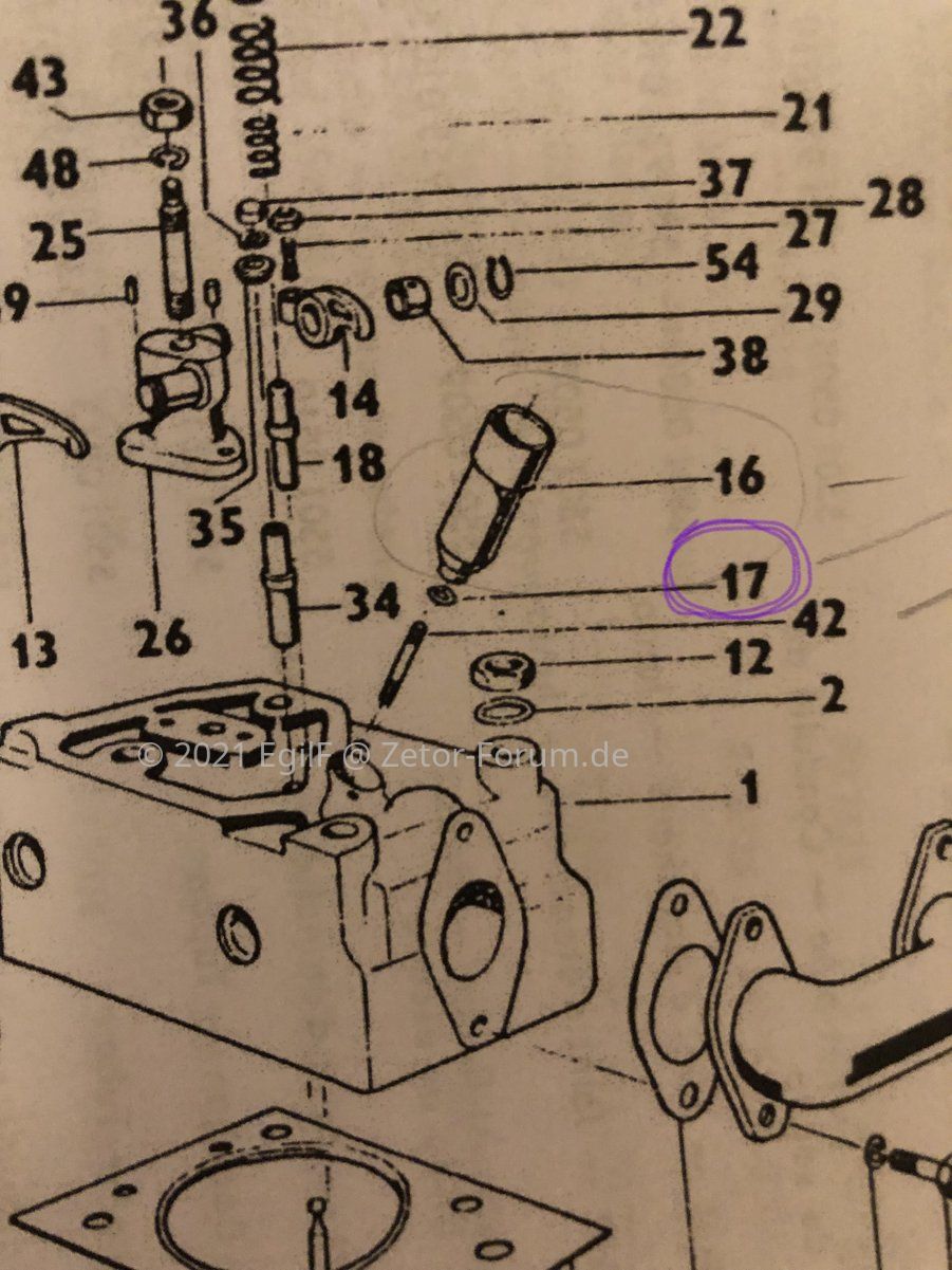

Soll die dichtungsunterlage (nummer 17 im bild aus dem katalog/ersatzteilliste) bei einem Zetor in den einspritzventilbuchsen sein? Auf dem bild sieht es so aus, als ob es außerhalb / unter der buchse wäre. Aber in dem video, das ich gepostet habe, ist die unterlegscheibe in der buchse.
Should the sealing washer (17 in the picture) be inside the injection valve bushings on a Zetor? In the picture it looks like it is outside/under the bushing. But in the video I postet the washer is inside the bushing.

Meine Erfahrungen beschränken sich nun auf Motoren am Zetor 50super.
In diesem Fall, sind die Dichtringe unter der Einspritzventilbuchse , zum Zylinderkopf (Wasserseite) hin verbaut.
Zu beachten wäre dabei, daß bis zu 3 Dichtringe verwendbar sind, um den Überstand der Buchse im Brennraum einzustellen.
Sie wären hier (50super) 0,3mm dick und ließen die konische Mündung einseitig plan mit der Dichtfläche sein.
Vorher wäre durch Messen zu ermitteln, wieviele Dichtungen untergelegt werden müssen. ;)
Kopf zur Montage der Buchse vorher erwärmen (80°C), Alu- Dichtringe einlegen, Buchse mittels passenden Dorn einschlagen, abkühlen, sollte dicht sein.
Oder zusätzlich noch mit Dichtmasse bestreichen. :D
Warum sollte es an den Nachfolgemotoren anders sein?

Order the washer together with the bushing. If you pull the bushing out you will see if the washer is under the bushing.
I paid Euro 3.44 for the injector insert 95-0502 in january 2021.
Bestellen Sie die Unterlegscheibe zusammen mit der Buchse. Wenn Sie die Buchse herausziehen, sehen Sie, ob sich die Unterlegscheibe unter der Buchse befindet. Ich habe im Januar 2021 3,44 Euro für den Injektoreinsatz 95-0502 bezahlt.
